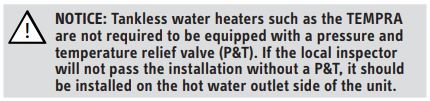

    Are you or your jurisdiction requiring P&T valves on electric tankless water heaters? We use the 2012 codes,
    P2803.1 in the IRC requires all residential water heaters to have P&T relief valves. UL 499 allows for no P&T relief for electric tankless units meeting the UL 499 standard. I know that the IRC would preempt the UL and that the most restrictive regulation shall govern. Does your jurisdiction require a P&T relief valve in this instance?

    Don't recall all the complexities of how the fuel-fired tankless system works but my understanding is the fuel burns at one temperature and therefore has the potential to exceed the temperature for the flow of water to be heated and require a PTR valve. Whereas electric has a duty cycle (on/off) and better control the heat the water to the set temperature.
    An example of a manufacturer's installation guideline of an whole house electric tankless unit invites

    It seems to me that if UL doesn't care about a pressure relief valve for electric tankless water heaters (of any size) why should the code be worried? An overabundance of caution will only lead to complications (where to route the discharge?) that will virtually eliminate anyone choosing to use small [electric] tankless units.

    Required....as long as it does not void the listing....

    It doesn't make sense to try to install a temperature relief valve on any tankless unit because it can't be installed in accordance with the listing: The probe must be located withing the top 6 inches of the storage tank.

    Thanks for all of your answers. The gas fired instant water heaters that I have inspected have all had provision for P&T valves. In several instances where there the P&T was missing, upon re-inspection it was installed. My question was generated due to an electric instant water heaters that had no provision for a pressure and temperature relief valve, this surprised me, so I learned more regarding UL 499. I certainly respect all of the collective knowledge here, so I thought that I would inquire how you handle this conflict between the code requirement and the UL listing.

    IPC 504.4 specifies "storage water heaters" when requiring a relief valve. Tankless water heaters are not storage water heaters.
    IRC P2803.1 requires a relief valve on appliances used for heating water or store hot water - so this required here, except maybe by R102.4 in the exception where it states the conditions of the listing shall apply if the code would violate the listing. So list leads to the question of - would an inline relief valve violate the listing? I doubt it would. Now, as it has already been stated, while a pressure relief valve may be installed inline near the appliance, the temperature relief valve is required to be installed in the tank which is impossible due to the lack of a tank. This brings up the question of - if one is required by code and it shall be installed in the storage tank, can you require the installation of a storage tank when there is a water heater present? I would never do this, but the code does lead you in that direction.
    So, my take on this is:
    Structures built under the IRC require a relief valve for all water heaters & hot water storage tanks. If there is no provision for a temperature relief valve on the appliance and no instructions on how to install one, only a pressure relief valve is required.
    All other structures only require a relief valve when there is storage of hot water.
